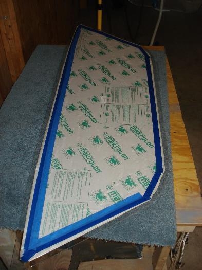

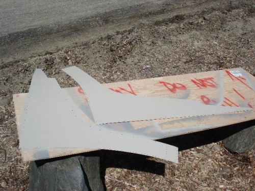

Scuffed up the inside surfaces of the side skins, primed and interior painted. Finished smoothing the edges of the rear window.

Interior paint on side skins.
Rear window edges smoothed.
