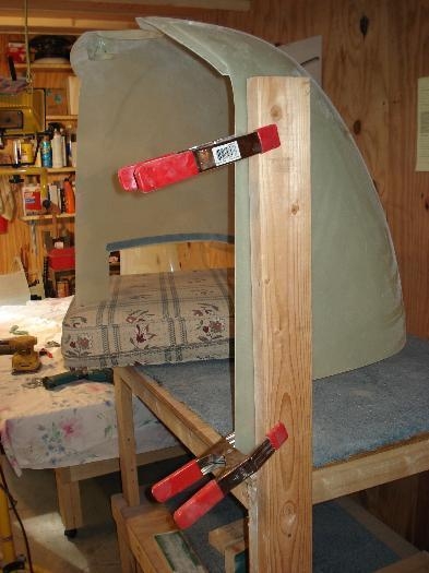

Jig for sanding straight edges.

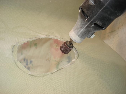

Rounding openings.
Rounding openings.
