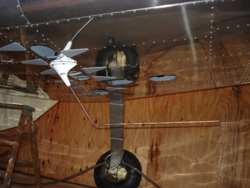

Date:  3-10-2010
Number of Hours:  2.50
Manual Reference:  42-11
Brief Description:  Installed antennas.
Installed the com and transponder antennas. Mounted the GPS and XM antennas on the F-1201Z Retaining Plate. The holes in the plate were in the wrong place and the plate did not match the figure on Page 42-11. Drilled new holes.
I think there is another error. On Page 29-02 K1000-08 (8-32) nutplates are installed on F-1201R. On Page 42-11 Figure 2 calls for AN526C632R8 (6-32) screws to go into these nutplates. I'll email Van's.
Com antenna.
Com antenna.
Transponder antenna - alias
Transponder antenna - alias "Stubby".
