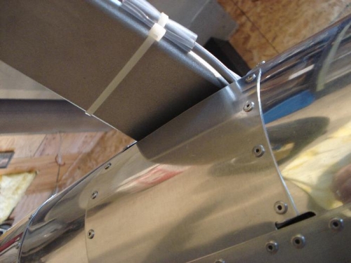

Re-routed the brake lines inside the fuselage to avoid moving parts and tied them down with cable ties.
Installed the cover plates where the gear legs come out.

Gear hole cover - looking up.
Brake lines secured out of harm's way.
