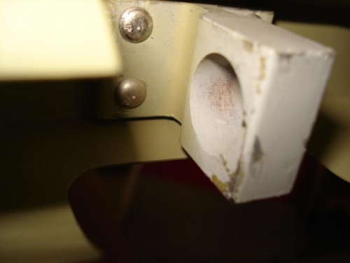

Date:  7-3-2012
Brief Description:  Built up new spar.
Had a bit of time between other activities at the airport today. Match drilled the new spar and the doublers for the hinge mount rivets. Riveted in place using -7 rivets. Matched up the fittings on the bottom of the spar and drilled all the holes. Match drilled the second skin for the stiffener.
Building up the new spar.
Hinge.
Hinge.
