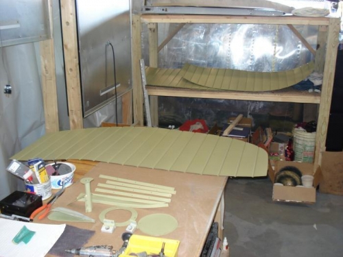

Brief Description:  Prepped/primed elevator parts.

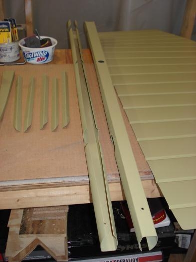

Since last entry we found that Univair has elevator spars and replacement parts cheaper than we first thought. Ordered and received two new spars and the doublers required by the AD. Also pulled two more 195 elevator skins from new old-stock to make the left and right elevators from.
Made an arrangement with Craig, the summer employee, to have his help part-time. Today we cleaned all the skins, spars and miscellaneous parts, and Chris primed them with a bunch of his parts.
I laid out the one large wing panel and trimmed to fit using the old panel as a template. Also cleaned and primed.

Elevator skins and parts.
New spars.
New spars.
