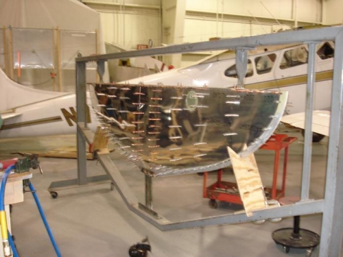

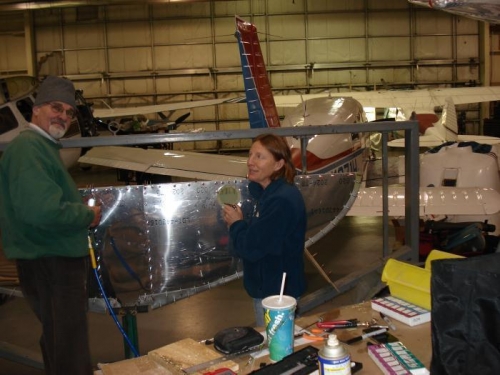

Brief Description:  Worked on HS reassembly.
Met Jeanne at FBO at 10 AM. Did a lot of strategizing about the order of reassembly. It will be:
1. Rivet center section skins, forward structure. 2. Remove lower skins, rivet upper. 3. Remove spar, rivet upper skins. Reinstall spar.
Bill helped us rivet the forward part of the center section skins. That went quite well. Jeanne is learning to do a good job of bucking, while I am getting used to the feel of the new rivet gun.
Corrected a couple of earlier areas having to do with the spar repair. Clecoed everything back together. Ready to remove lower skins and start riveting the upper skins.
Co-owners working the HS.

Prepping for skin riveting.
