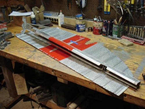

Brief Description:  Removed damaged rudder skins.
Used the cutting wheel in the new arbor I bought for my die grinder to thin the metal over the spot welds. Popped the welds the way Bill had showed me and drilled out a few more rivets. The skins came off with only minor damage - they will make good patterns. Spar looks usable - whew!
Rudder skins separated from spar.
