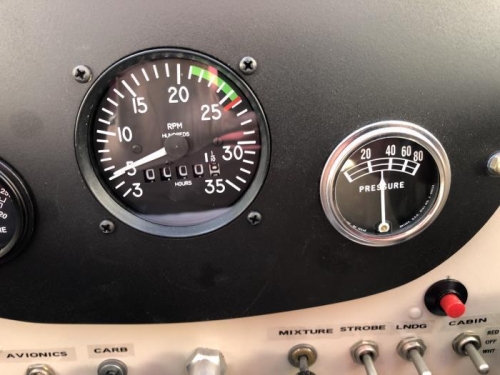

Brief Description:  Good oil pressure!

Pulled airplane out and did a ground run with similar parameters to the 9/28 test run. Here is the comparison:
Minute RPM 9/28 Pressure & notes 10/3 Pressure & notes
0 800 Up to 42 in LT 10 seconds. 45 Immediately
1 800 42 45
2 1000 42 45
6 1000 30 45
7 1000 25 45
8 1500 30 45
9 2000 30+ 50
10 2000 25 Oil temp 100 50
11 1000 13 40 Oil temp 100
11:30 800 5 39
11:45 500 0 30
Analysis: Gauge replacement probably no significant factor. Slightly stronger spring probably caused small increase in top-end pressure. Removing debris and lapping valve probably accounts for major changes. I had missed the step to lap the valve during overhaul, and simply reinstalled it as it came out. Instructions for lapping were buried in the middle of a paragraph in the overhaul manual.
