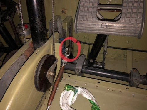

Reversed rudder cable clevis bolt to increase clearance to tunnel cover, based on indications of contact between nut and cotter pin in previous installation.

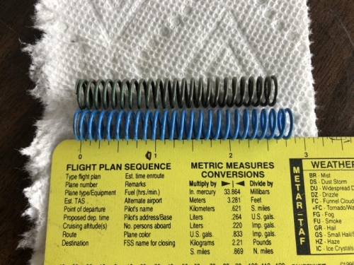

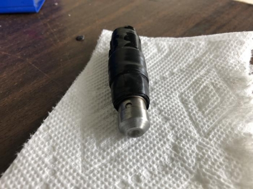

Received oil pressure gauge and oil pressure relief spring from A/S. New spring is 1/4" longer. Removed oil pressure relief dome nut, spring, and plunger. Observed what appeared to be debris on valve seat. Cleaned and lapped valve seat.
Bolt reversed.
Bolt reversed.
New spring longer. More pressure?
Plunger wrapped for lapping.
