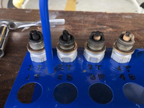

Once again tried to find oil leak. Seems dry at back of engine around accessory case, but some wetness observed under engine block itself. After 12-minute test run no oil leaks observed.
Ran up engine and took notes as follows: Test conditions: OAT 75F, no wind.
Minute RPM Oil Press, notes
0 800 Up to 42 in LT 10 seconds. Two gauge “jumps”.
1 800 42
2 1000 42
6 1000 30
7 1000 25
8 1500 30
9 2000 30+
10 2000 25 Oil temp 100
11 1000 13
11:30 800 5
11:45 500 0
Removed top plugs. See photo. Cylinders 2 & 4 normal color, 1 & 3 appear rich.
Performed warm compression test, all cylinders 78/80.
