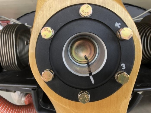

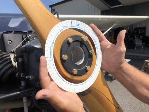

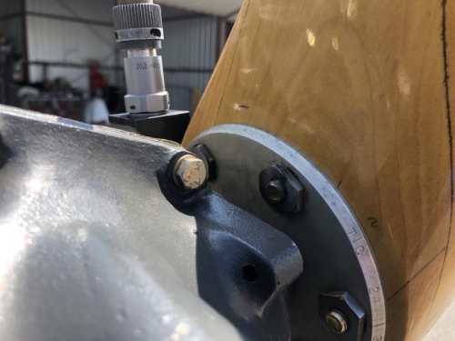

Made three runs of the MicroVib balancer.
1. Verify yesterday’s reading on position 2 and get baseline.
2. Heavy weight for calibration.
3. Final run with two longer bolts and washers.
Final weights:
Orientation: TDC mark up (position 2 as defined yesterday)
60 deg point 7.9 grams (longer bolt and four washers).
120 deg point 6.6 grams (longer bolt and three washers).
IPS reading .023 – very good per Ed.

Position #2 best before balance.
Marked for future removal/reinstallation.
