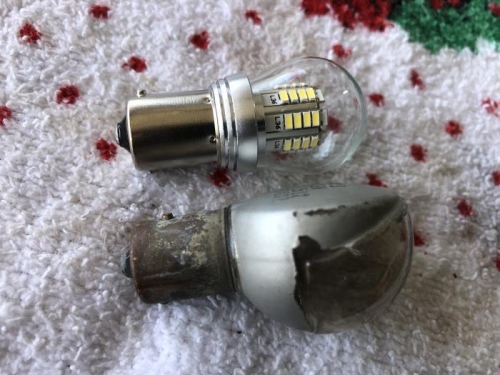

Brief Description:  Generator, primer, nav lights.
Modified mounting hole and installed noise filter on generator. Safetied long bolts. Gave connector nuts to Tom for ACE trip. Lubed and reinstalled primer. Dissassembled old distributor and spark plug wires. Gathered parts of nav lights, tried LED bulbs, they do not fit. Took housings home to repair.
Sam put another 5 gallons gas in right wing. No leaks.

Different bayonets
Different bayonets
