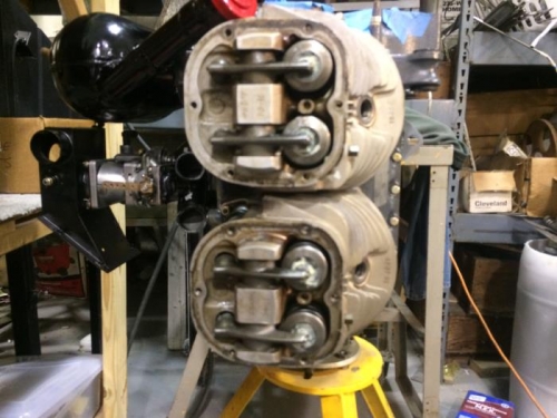

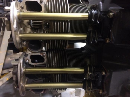

Brief Description:  Finished installijg cylinders and associated parts
Removed cylinder #2, removed exhaust valve, checked dimensions. Re-lapped valve and seat, cleaned and reassembled. Same gap issue. Ordered new and longer pushrod, reinstalled cylinder. Torqued all clyinder nuts to specs.
Removed all rocker arms and checked oil port openings and pushrod openings, per Ron Rios, reinstalled. Installed all pushrod housing rubber cooonnectors. Installed intake fitttings to all cylinders.
