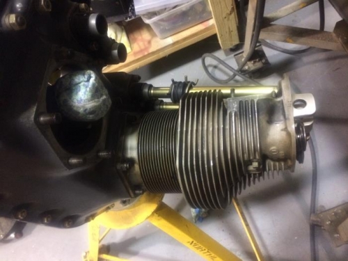

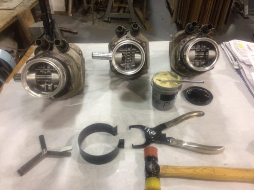

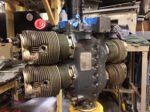

Brief Description:  Feb catchup, installed cylinders.
On vacation most of month. New piston came OK. Rings from Superior didn't fit, had to return them, ordered and recieved rings from Fresno.
Installed new ring set from Fresno, good fit. Installed pistons in cylinders and cylinders to engine. Installed push rods, rockers, checked lash. #2 cylinder exhaust valve near upper limts ( 30 -110).
