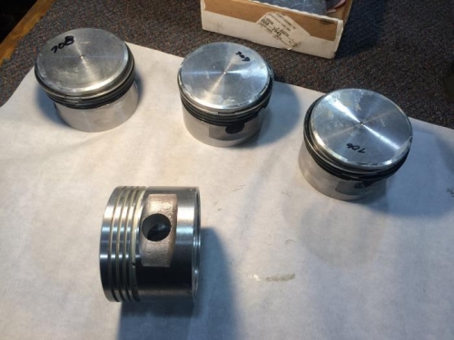

Brief Description:  Received pistons, rejected one.
Installed and secured induction system with special washers and nuts, used blue loctite on nuts. Received new pistons, greased and installed ring sets. Discovered damage to one of the new pistons and called Fresno for a replacement.
Three good, one bad.
Dent and burr on land next to oil ring.
