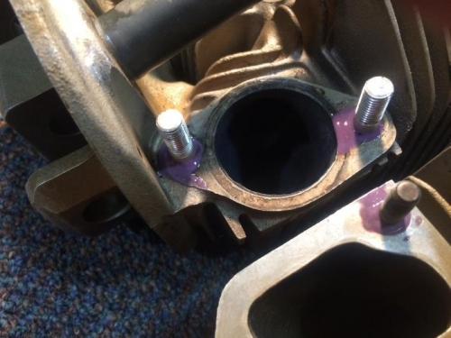

Brief Description:  Prepped cylinders, pistons, rings for cylinder ins
Three day catchup. Replaced missing intake and exhaust manifold studs with slightly longer that were in stock. Did final honing of cylinders and thoroughly cleaned. Cleaned pistons, weighed, matched. Checked end gaps, installed rings on pistons.
New studs.
New studs.
