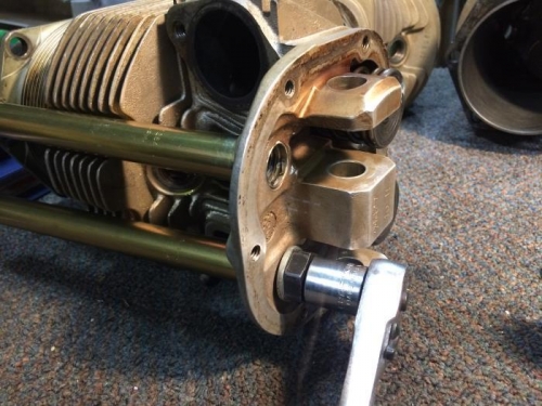

Installed pushrod tubes.
Went through and inventoried all spare parts in Ken Sherwood boxes. Used Ron's swaging tool to install pushrod tubes all cylinders. Sealed with wicking Loctite. Installed rubber seals and spring clamps.
"The tool."
