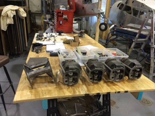

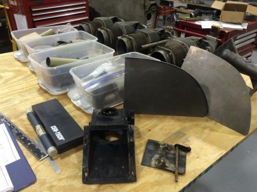

Brief Description:  Prepared to work on cylinders.
Got out all cylinders and double checked previously taken measurments. Confirmed all rocker bosses out of spec. Located reamer (Bill's) for reaming boss holes, made test hole in thin aluminum, verified bushing are a good fit. Recieved new gear box side plates from Chris, turned over to Bill for further work. Checked carb heat box after disassembly by Chris.
