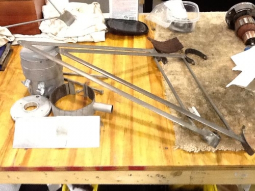

Bent strip of metal to contour needed for wing patch. Went out to Countryside and found they had correct replacement bearing. Tested armature on "growler". Cleaned and masked housing for primer. Tom helped me force new grease into new bearing. Re-installed gears on generator. Fabricated patch piece out of .032 sheet, using shear, break, and rollers.
Armature with new bearing.
Parts ready to prime/paint.
