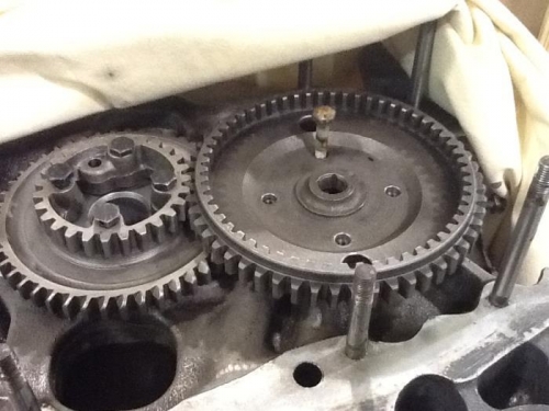

Brief Description:  Cam gear bolts missing.

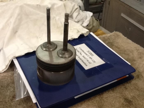

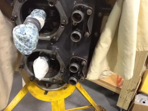

Began installing crank and cam gears. Can't find bolts for cam gear. May have to order new ones, Part # 22534. Checked dimensions of lifters. Drained them of oil. Lubed and installed, inserted keeper springs. Cleaned and installed housings. Cleaned and bead blasted #1 piston and valves.
Gears without missing bolts.
#1 piston & valves cleaned up.
Lifters & housings installed.
