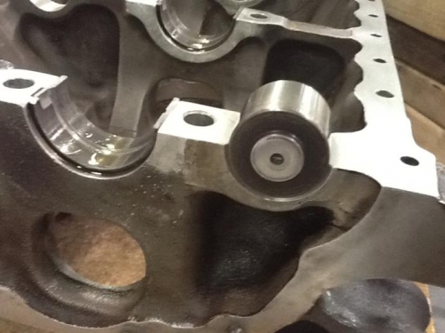

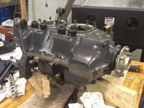

Checked measurements of connecting rod bushings. Double checked measurements of the two pinion gear shafts, picked the worst one, cut off shaft and polished. Reassembled case internal parts and coated surfaces as per Continental instructions. Mated case halves and torqued down through bolts and flange bolts.
Cut off pinion
Cut off pinion
Together again- rear.
Bottom 1-3 side.
Bottom 1-3 side.
