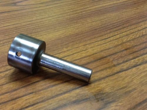

Brief Description:  Found bad pinion.
Cleaned flanges on case halves, readied to mate, showed Bill. He suggested I check and blow out oil paths, which I did. I decided to measure the starter pinion befoore assembly, and alas, found it worn beyond limits. Suspended operations on the case pending decisions relating to starter. Put away parts and switched gears to checking dimensions on all cylinder parts.
