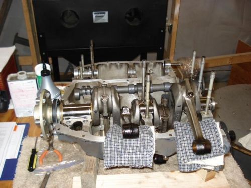

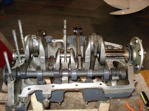

Installed internal parts.
Installed cover pads for fuel pump and oil cooler and torqued down. Installed valve lifter bodies. Installed prop seal on shaft. Installed cam & lubed lobes & lifter surfaces. Installed cam. Installed crank assembly and thrust washers. Checked dimensions.
