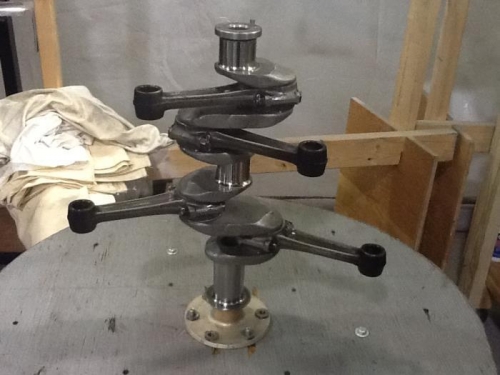

Date:  12-19-2012
Number of Hours:  7.00
Brief Description:  Assembled crank and connecting rods.
Cleaned up and reinstalled prop flange bushings. Mounted crank in work stand. Cleaned connecting rods and crankshaft.Went to NAPA for plastic gauge stuff and checked all crank and cam bearings for clearances. All checked good. Also checked rod bearings - same. Removed and cleaned bearings. Assembled rods to crank, torqued to proper settings and installed cotter pins. It's really good to have one subassembly completed!
Crank and rods assembly.
