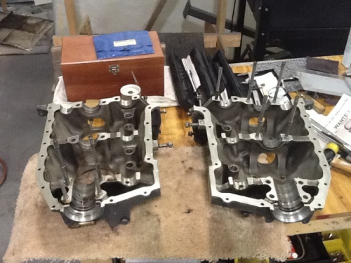

Cleaned mating surfaces.
Used laquer thinner and scotchbrite pads, and razor blade to remove all old gasket material and cement from all mating surfaces on the case halves and end cover.
Nice and clean!
