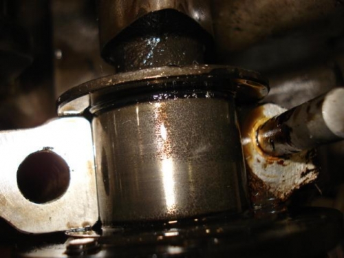

Proceeded to remove all the flange bolts and other through bolts. Had a hard time getting case halves apart due to front crank seal glued in very firmly. Removed the crankshaft, cleaned and packaged for shipment. Found some black areas (corrosion?) on camshaft bearing surfaces. See photo 3 below. Will try to polish that of and see what we've got.

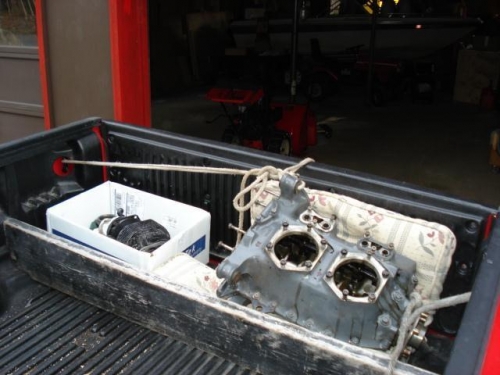

On way to FBO hangar.

Funny stuff on cam.
Funny stuff on cam.
