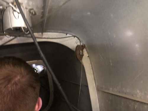

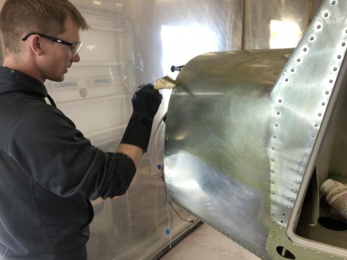

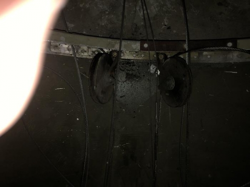

Brief Description:  Aileron pulleys and Alodine.
Removed upper and lower aireron pulleys and brackets. Brackets had a lot of surface rust and incoorect hardware on the lowers. Cleaned and primed uppers and reinstalled with new correct hardware. Left lowers off and took brackets home. Scrubbed and cleaned entire fudelage, and Alodined.
Upper pulley.
Upper pulley.
Lower pulleys.
Lower pulleys.
Alodine.
Alodine.
