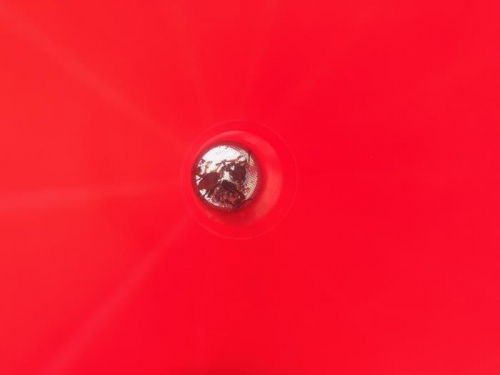

Removed the right quickdrain. Initial gush of fuel was very dirty – observed as it ran up my arm. Drained remaining fuel through strainer funnel. A lot of debris came out including bugs etc. See photo. This indicates that both tanks have a lot of foreign material in them that is larger than what will come through a quickdrain, and the tanks and the whole fuel system needs to be flushed before further flight. Went to ACE and bought a small pump-up sprayer and attempted to buy a fitting for the quickdrain hole to allow connection of a tube. Found out the quickdrain is not an NPT thread, as the early 120’s were originally equipped with. It is instead a non-NPT thread used on later 120’s and the 150 line. I guess the tanks were changed out somewhere over the years. Anyway, the quickdrains that are installed are CAV-170’s. Spruce has them, and they also have the O-rings for them, should they need to be replaced. Today I will attempt to flush the tanks.

Bottom of strainer funnel.
