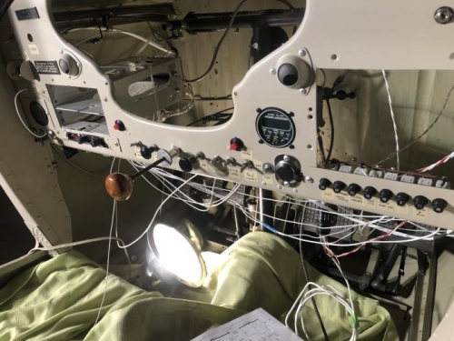

Brief Description:  Continued electrical work.
Made temporary connections to small battery, tested all circuits. Identified red and white wires, labled, terminated cockpit light wires both sides. Identified "hot" wire to tail. Secured the other #20 wire and labled both ends as a spare. Looked at TailBeacon and determined it has a hot and a ground wire. When we hook it up we will run a ground wire from aft fuselage bulkhead and join the existing power wire from up forward to the wirein the rudder.
Removed radios for safekeeping. Installed new 10A CB and ran wire to starter button location. Decided not to use the button previously purchased because of difficult operation.
Loosely installed all CBs, switches, aux outlet, and dimmer.
