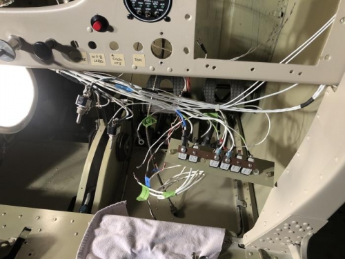

Nobody in T since Wedmesday, so hopefully no COVID19 bugs. Went to deserted FBO and picked up switch and breaker I needed. Isolated myself in the T. Pulled out old skin and made template, positioned for drilling holes for data plate mounting on glare shield, as was originally. Reorganized area and my bench for electrical work.
Hooked up LED cockpit light and tested positioning in dark hangar.
Applied temporary tape labels for new switch and breaker assignments.Removed CB panel and uninstalled all switches for access. Clipped cable ties and dropped switches and breaker panel. Changed out one breaker and one switch, as required for new set up. Got #12 wire from main hangar and wired landing light lamp circuit to wing and belly. Made all connections to new landing light switch except for #12 feed from CB.
One LED white light. Red similar.
Everything pulled down for access..
