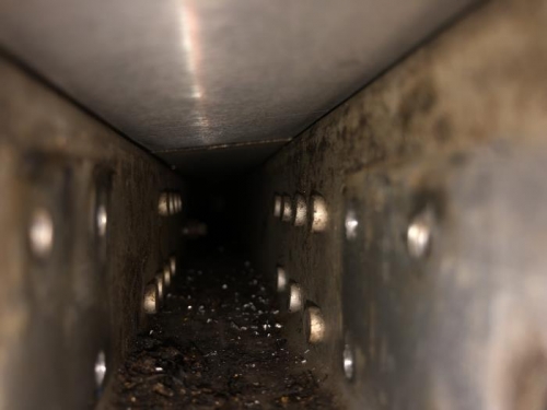

Mixed a small batch of Poly-fil and applied to two small dents near tail. Installed new Univair parts in broken cowl latch. After discussion with Bill removed spacers from right-side ends of both fwd and aft main spars to enable inspection of insides for corrosion or cracks.Took a preliminary look, will wait for help from Jeanne on left side.

Inside of spar.
Inside of spar.
