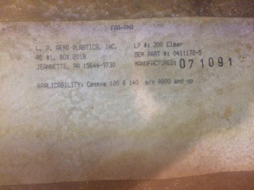

Brief Description:  Worked on windsheild.
Found that we had riveted the new skin pieces that are on the sides of the windsheild without adding the strips that form the windsheild channel. Drilled out all the AD5 rivets that should not have been installed. Fabricated new "joggled" strips, fitted, and clecoed in place.
Jeanne cleaned skylights and removed old vinyl material from the inside. Jeanne cleaned the old windsheild, and we decided to use the new one. Jeanne removed the protective coating from the new windsheild and covered with paper.
Sticker - new windshield.
