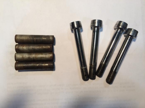

Jeanne brought in the bolts Ken had finally found (and polished up) and we test fit them,and they are correct! I removed the rubber mounts and sleeves. The sleeves are pretty rusty and one is cracked. WIth Kurt's help Jeanne ordered tubing to make new ones.

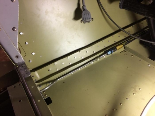

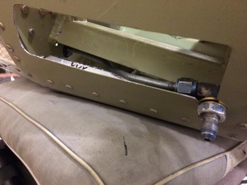

Jeanne tried to install lft side brake line while I removed baggage area curtain.
After Jeanne left I got Bill to help me jack up lft side and remove gear leg. I noticed that I had not trimmed flange on bottom skin to size, and that was what was causing diffculty in installing brake line. I trimmed it with the new oscillating saw, and was able to install all pieces of left brake lines. Will fll with fluid and test next.
