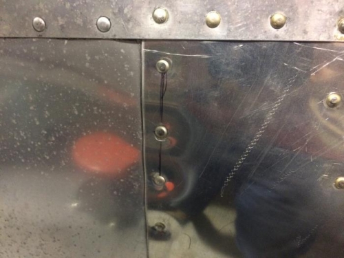

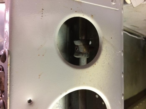

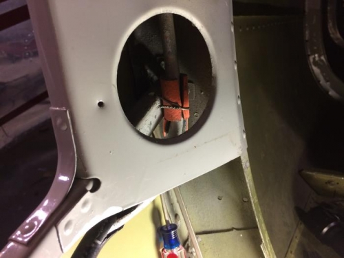

Repaired two rivets.
Removed gas line behind right door frame to gain access. Pulled bucktails, drilled oversize holes, and installed repair rivets in two location just aft of right hand door. Jeanne and I must have missed these during dissassembly way back when.
Loose clamp.
