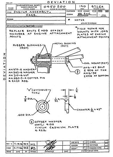

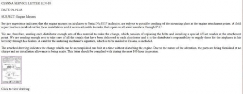

Brief Description:  Got information about motor mount attachment.
We had been looking for the internally wrenched bolts that attach the motor mount to the motor. Through inquiries on the Cessna 120 org forum became aware of the AD and SL that changed these bolts back in the day. New(er) system used standard AN bolts with special shoulder washers. See pictures.
