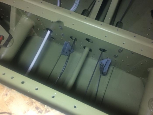

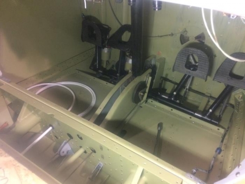

Brief Description:  Began work on re-installation of flight controls.
Sam was able to install right rudder cable pulley (on left sideof airpane) under the baggage floor, and also inspect and lube the other 5 pulleys under there. Installed control column at pivot point and connected elevator push rod. Began ereinstalling the aileron chain and linkages, found they need some restoration, pulled out and set aside. Noted bad condition of rubber boots on yoke universal joint. Ran aileron and rudder cables through gear box. Began installation of rudder pedals.
