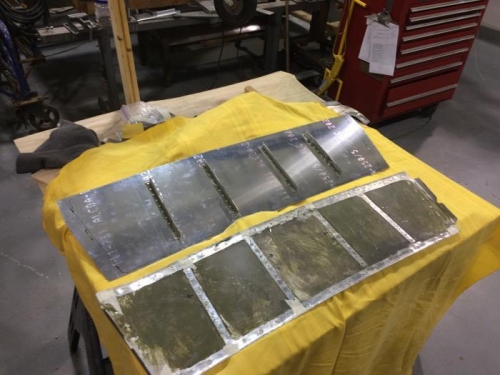

Fabbed new belly skin.
The .040" T3 we had ordered from Aircraft Spruce came in. Jeanne and I cut new belly skin 1/4" oversize ( to be trimmed at installation) and cleaned up and riveted in place the four stiffeners. Bill worked on the jig for the gear box repairs.
Old and new belly skin.
