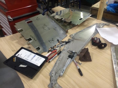

Since last entry the bulkheads have been completed. Bill and I need to inspect them and send them out for heat treatment to turn the T0 into T3. I fabricated new floor panels, and they are complete except for the flange bends which I willl ask Bill to help me with. Jeanne has been working on cleaning the old silicone off of the windsheild strips. Bill has been progressing onthe rebuild of the door post bottoms where they join the gear box and other structure.
Alsost completed floor panels.

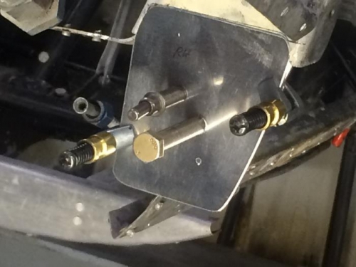

Door post repair in process.
