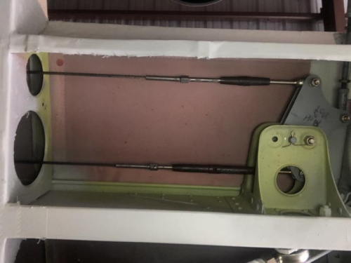

Connected aileron control cables. Had to remove a couple of turnbuckle barrels and get them turning freer. Centered bellcranks and set tension preliminarily to about 20 pounds. Will need to final adjust and safety later.

Right wing aileron cables.
