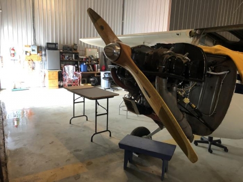

Brief Description:  Adjusted dihedral.
Adjusted struts for 1 degree dihedral. Had to raise left wing, right wing was OK. Checked incidence angles on wing bottoms and they are just about equal. Adjust after flight testing if necessary.
Installed nuts and tightened all six strut bolts.
Finished right vent tube, applied felt, hooked up scat tubes and install vents both sides.
Installed prop, torqued to 17 ft/lbs, safetied. Installed spinner with new hardware.
