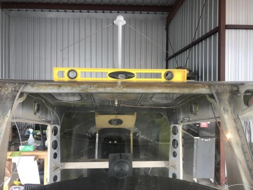

Leveled airplane at carry-through spar, and checked dihedral. Right wing close to 1 degree, had to adjust left wing. Checked angle of incidence, they seemed about equal. Tightenened all six lift strut bolts.

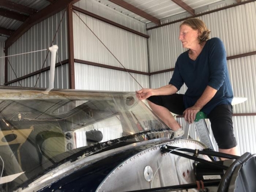

Conferred with Bill amd Sam, decided windshield must be removed and reset. Jeanne and I spent the afternoon removing it. Black sealant terrible to get off.
