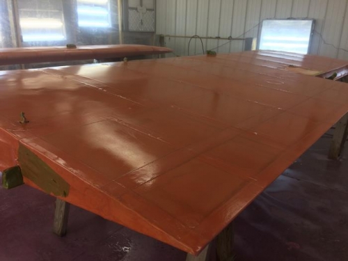

Brief Description:  Third sprayed coat Poly-Brush, bottoms.
Added reinforcing tape along bottom trailing edge metal. Made minor fixes, smoothed some spots. Decided to add a third coat of sprayed Poly-Brush to tops and bottoms, since we have extra material and John sprayed the first coat pretty thin.
Sprayed extra (3rd) coat of Poly-Brush on bottoms both wings. Looks like we got a good job and the wings are REALLY pink now!
