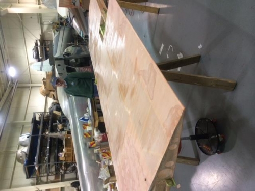

Brief Description:  Continued covering the left wing.
Over the past week I (we) finished gluing the butt rib, fitted and glued the aileron opening, ironed to tighten, cut out for the protrusions and covers, applied the brushed-on coat of PolyBrush, applied all the rib reinforcement tapes, burned the holes and inserted all the rivets on the top surface.
