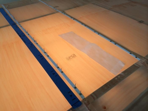

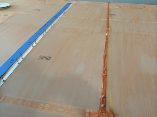

Nice quiet Saturday at the airport. Worked in the big hangar with the door open, so no mask necessary. Applied first coat Poly-Brush to bottom of right wing. Applied reinforcing tape to two ribs as a test. Lit up from below with big light, found holes no problem. Melted holes using new soldering iron. Inserted rivets, set them in one row, and brushed on 4 coats of Poly-Brush as instructed. It is a long ways from the last rivet in the rib to the trailing edge. Common sense says there should be at least one rivet holding fabric down to trailing edge metal. Drilled holes for those 1 1/4 inches back from front edge of trailing edge metal.
Two rows with tape and rivets. Lit from below.
Rivets set, four coats Poly-Brush applied.
