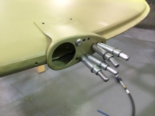

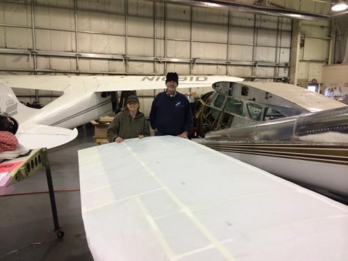

Continued prep for right wing covering. Drilled out rivet holes under tank to #30. Got Bill to inspect. Added rivet to lod repair. Documented all repairs for Form 337. Tried to use nav light bracket to support end of wing. Found three out of four mounting tinnermans broken. Drilled them out and installed nut plates for 10X32 screws. Slipped envelope on to check. Nice fit!
Nav light repairs.

Rolling out the sock.
It fits!
It fits!
