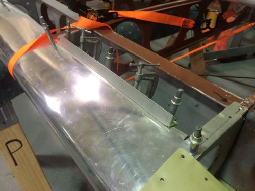

Monday and Tuesday puttered with right leading edge. Match drilled more holes. Researched root vents - found this airplane had left vent only. Deburred all holes leading edge and ribs. Made stiffening bends in bottom trailing edge of the leading edge skin.
The Peck Edge Bend Tool.
