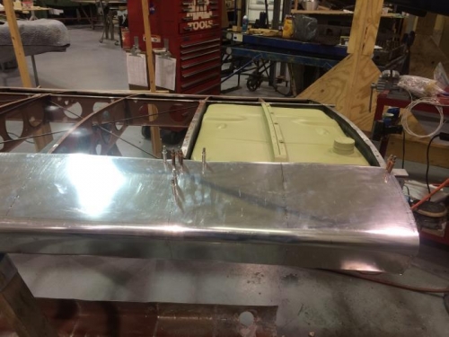

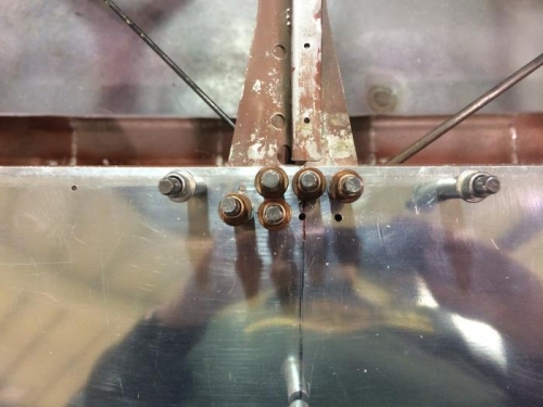

Brief Description:  Worked on right wing.

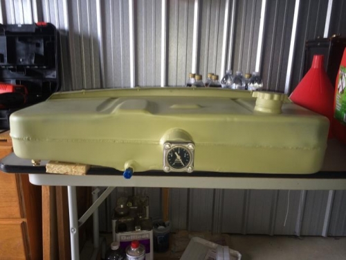

Flipped right wing back and forth to drill reamaining holes where the big ribs meet the spar. This involved riveting one hole in each section to correctly align the remaining holes for match drilling. and later removing them. Removed the white foam strips under the tank which were too thick. Found that original material was thin felt. Filled the left tank down in the T hangar to the filler neck for leak tests.
Holes drilled at rib-spar juncture.
Right tank test fit.
Left tank full of fuel.
