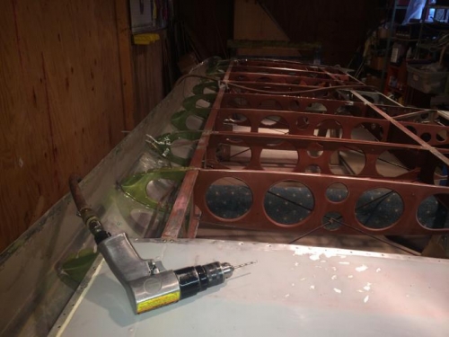

Brief Description:  Completed removal of left wing leading edge.
Used die grinder with cutoff wheel to remove the pop rivets that had been used to secure most of the leading edge to the ribs. (Not able to drive out the mandrels to do it any other way.) The skin, when removed, sprang back to almost flat. It was under a lot of tension, and exhibited quite a few dents and bumps where it apparently tried to kink while being installed.
One side un-riveted.

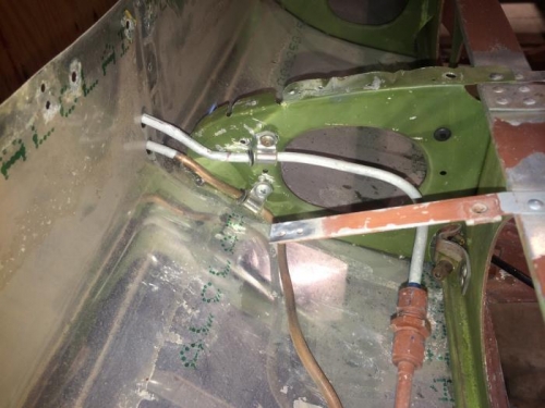

Pitot/static tubes mounting details.
