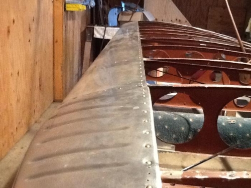

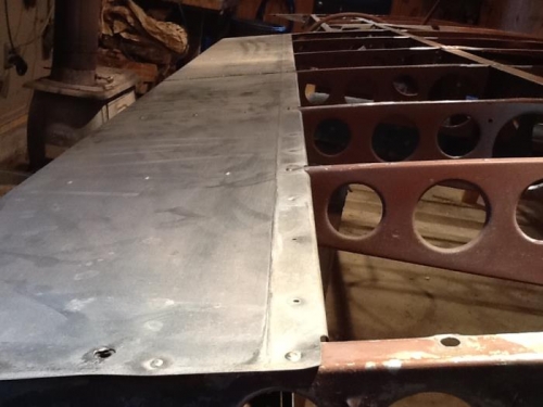

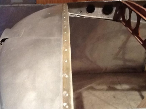

Sam and I worked on repairs to the top of the wing. We replaced all the rivets that had been removed with the wing skins. One additional cracked rib tab was removed and patched. The crack discovered yesterday was stop drilled in three places.
Leading edge rivets.
Trailing edge.
Trailing edge.
Wingtip.
Wingtip.
